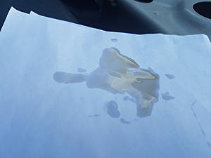

Nameless's Avatar
Joined: Apr 2018
Posts: 5
i'm new to CVT. But from what i've read, its been over filled and is the wrong colour.
I take it, being this colour means time to change?

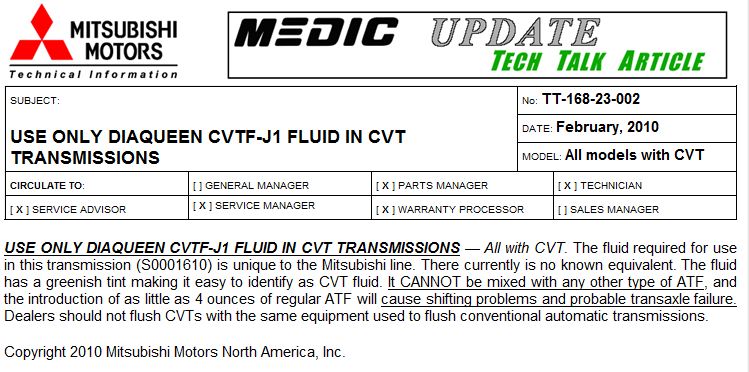

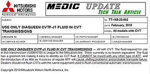

Do not use any substitute. You will regret it.
Use only what is required for your vehicle. If your CVT fluid is green use DiaQueen CVTF-J1. If your current fluid is almost transparent use DiaQueen CVTF-J4. Generally darkened color is the sign that is due for the change.
