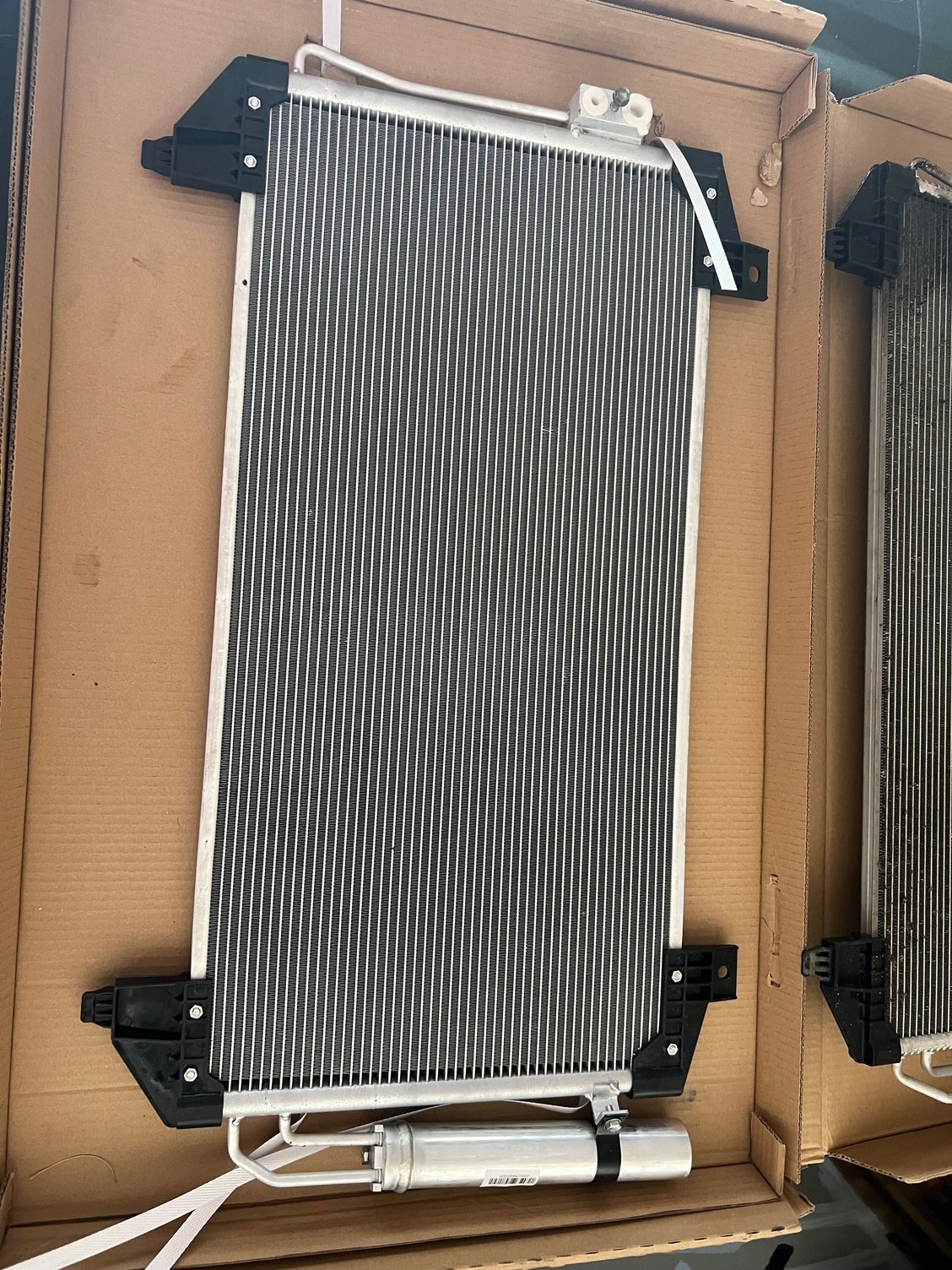

Mine is a 2016 with dual zone. No issues getting evaporator from mitsubishiparts.com Took the old one out and put the new one in. Not a big deal once the assembly is out. Will sell my used OEM one for a good price.

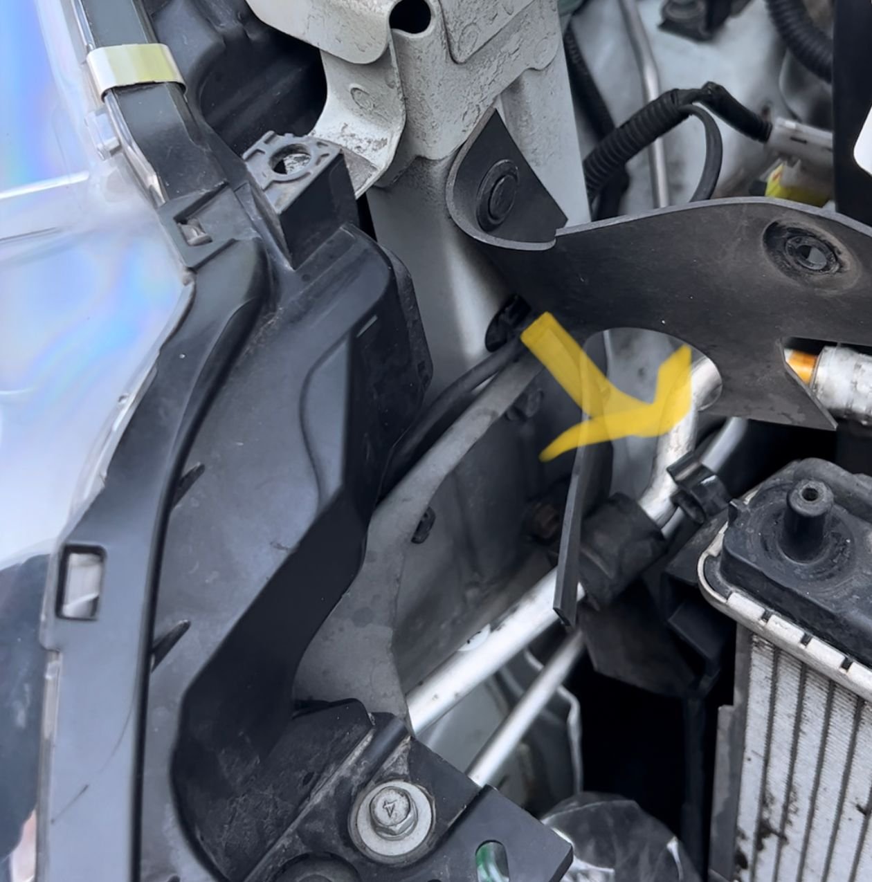

Replaced my condenser today with a GDP brand which resolved my leak. Pretty good fit, just the clip is a little off, might put some black tape or something on it to keep from rubbing…
Attached a pic of the clip (before condenser installed).

Yep, ice cold! Hardest part was getting the upper air flow guide out so I had more access to the lines and bolt. One push pin requires a bumper removal so I just forced that one out That larger diameter line was a pain to get out of the condenser. Trick was to wiggle and while pulling. Also helps if you have another person to push the radiator back and the trans cooler forward so you can guide the condenser in easier. Overall, not to bad, better then pulling the dash out…
I also cleaned up the radiator a little, hard to see from pic, but you can see some brown dirt/grass, etc.
