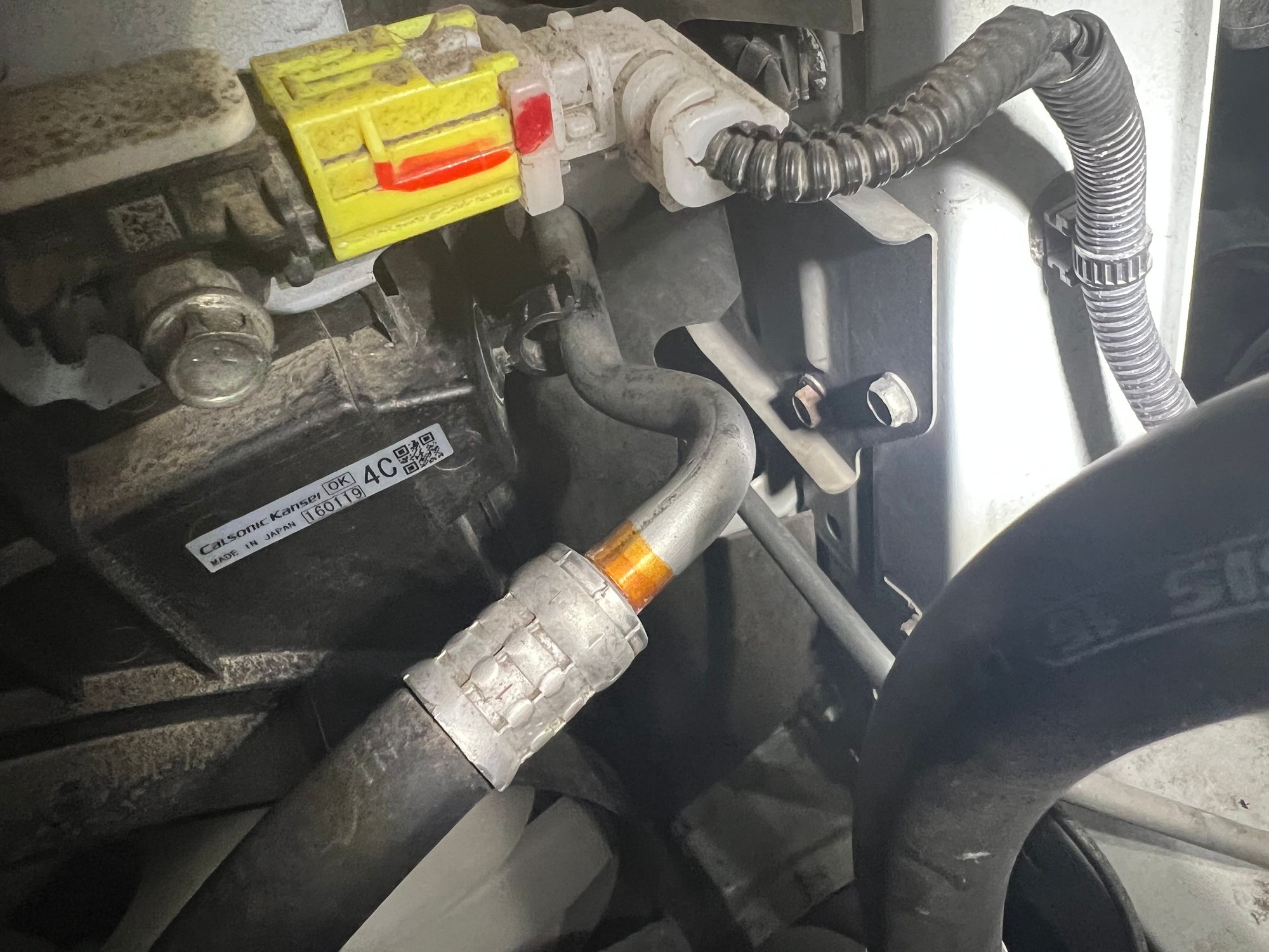

Ended up stretching the clip a little and put some super mole skin on the pipe to reduce any friction. Not sure if that’s a legit repair, but felt like I had to MacGyver something to reduce the friction on the pipe.
Also installed new clips to hold the cover down. Good as new Unless I add a little more oil, I think this case is closed!

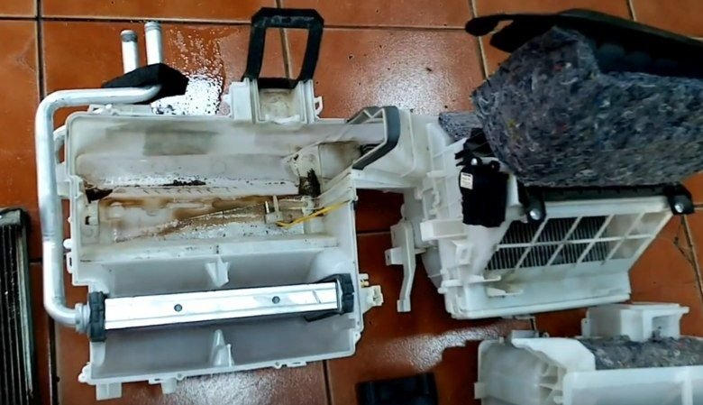

I was thinking of injecting the foam from where the cabin air filter is inserted, but the following photos show that this may not be a good idea. You can see the cabin air filter through the housing on the right. The evaporator is in the part of the large housing on the left.
I'm thinking that the foam should be sprayed in through one or both of the middle ac outlets on the dash.
Alternatively, do you think that it would be possible to drill a, say, 1/4" hole into the front of the white housing righ in front of the evaporator and spray it right in there? I don't know if that part of the housing is even accessible without removing a bunch of stuff. You are the expert on this. After the cleaning, one could just dry the plastic area just outside the hole very well and put a pice of black Gorilla tape over the hole, or plug it with a rubber plug.

Ideally the foam is supposed to be injected up through the condensate drain hole. The problem for me would be locating exactly where the drain hole is under the vehicle. I suppose one could jack the car, get under the vehiicle and have someone squirt some water or foam into one of the AC vents, as shown in the video, and the person underneath locates exactly where the hole is and then, after the flow stops from the hole, insert the flexible plastic line into the hole and blast away. It's going to definitely be easier to squirt the from in from the top than from the drain hole. Also, there's a plastic cover under the vehicle and maybe it obstructs view of the hole.
(Edit: After some searching, I found the following short thread about locating the condensate drain hole on an '03 Outlander. I'll take a look on our vehicle to see if it's the same arrangement. If it is, I think that it may be very difficult, or impossible, to get the foam hose into from underneath the vehicle.
https://mitsubishiforum.com/forum/mi...er-pics-36424/ )
The other question is how effective the foam will be at cleaning the evaporator. You just fill the evap compartment with foam, let it sit and then drain. It's not going to be like using a brush, that's for sure.
While I'm typing, as I look at the two photos of the HVAC assembly removed from the vehicle, I'm not exactly sure how air flows through it, but I'll take a shot at it.
The squirrel cage fan sucks into its center either outside or inside air through the cabin filter. It seems there's a flapper above the air filter that can move so that the incoming air is through those windows or through that insulated chute that, presumably, is connected to a plastic inlet through which outside air passes.
The fan blows out outside or recirculated inside air through the passage that connects the two halves of the assembly into the compartment where the evaporator resides. After moving past/through the evaporator, the cold air is directed to all the vent openings in the dash.
Where is the heater core in all this? Is it also somewhere inside the plastic assembly or completely separate from it?

The heater core is in front. The evaporator is behind the heater core. Should be easy to find the drain. Just run the A/C then jack it up. Should find the water dripping. Maybe you can inject it where the resistor goes. It’s cooled by the heated sink and air flow so probably can’t run it long.
