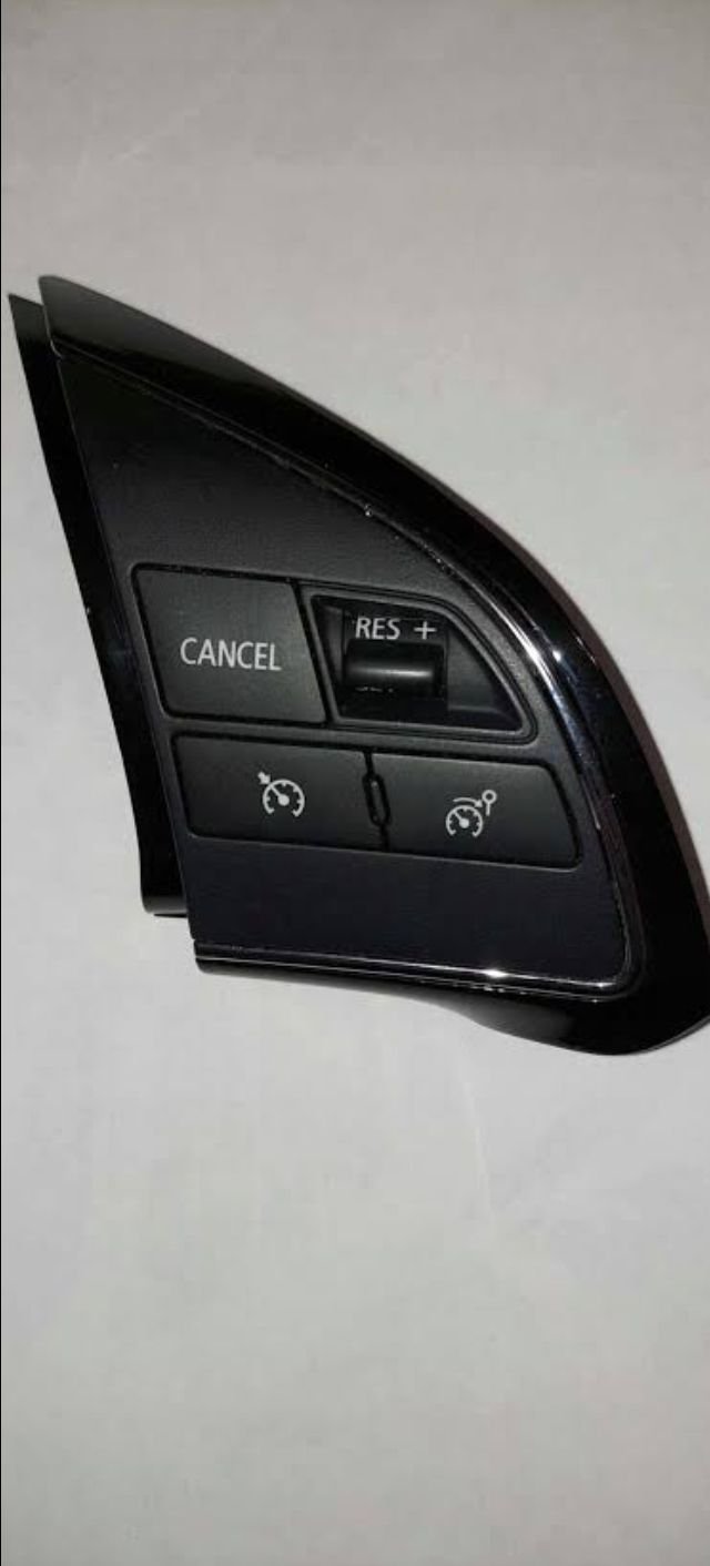

Enter your vin into Partsouq part catelog and find steering wheel
find the p/n for the steering cruise control withe the Speed limiter. Mine was 8602A116
I ordered mine from mitsubishi and got next day for $180
