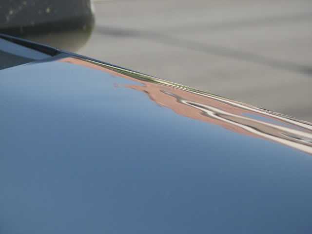

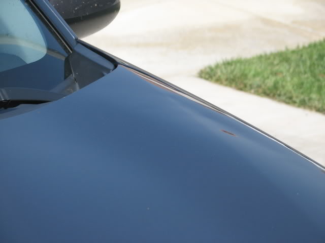

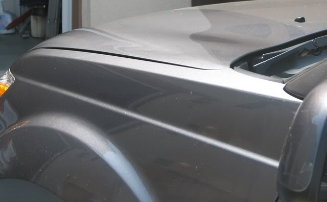

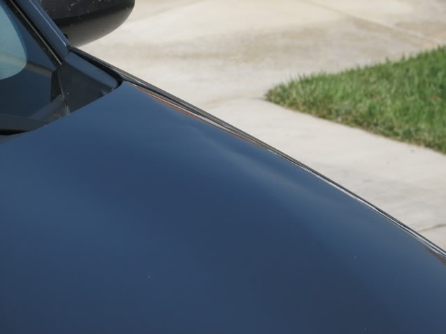

I finally took some images. It ishard totell unless you get the sun right in the photo. You can see it is in the same place as the rest. In addition I show a profile photo that shows how misaligned the hood is compared to the fender.As most of you who have this issue know, it looks much worse in person.
Has anyone had any luck with the dealership so far?
