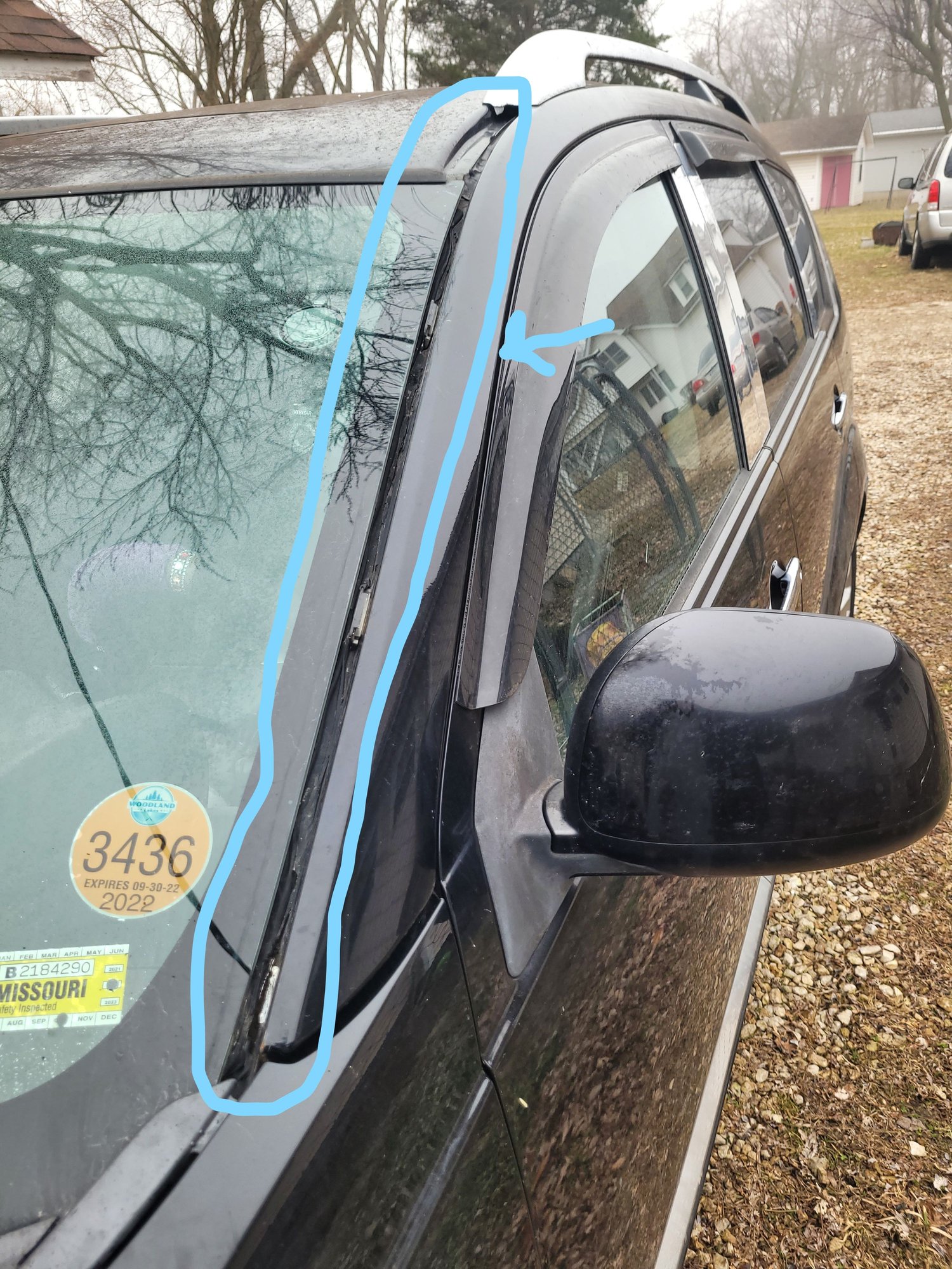

This should be simple, but everywhere I look online for Windhsield Trim I get everything but this piece lol. Can someone point me to the part # for this black plastic piece on the driver's side that snaps in next to the windshield and runs all the way up to the roof rack and tucks under it slightly? I have searched Ebay, Mitsubishi OEM parts sites etc and they show the piece that goes across the top but not this one. Every clip on it was broken when we got this vehicle and it flew off. 2008 Outlander ES
Thanks in advance, I attached a picture and circled where it was.

Part reference 71145L in the parts Application shows part number 7400A055 for a 2008 Oultander, although this 7400A055 number may be different as they can be region specific.
If you go to a Dealer and he types in your VIN to his ASA (aftersales support application) and put in the reference 71145L it will bring up your vehicle and he will be able to get the right part
