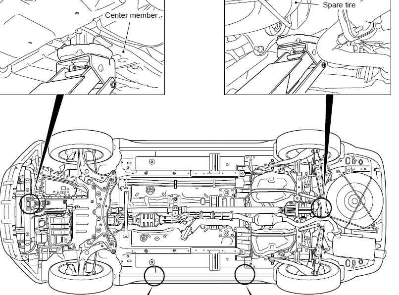

The 2007 Outlander owners manual shows the following for jack points:
https://mitsubishiforum.com/forum/mi...-stands-27347/
It appears that they suggest using the cross-member directly to the rear of the differential, and directly in front of the spare tire. This spot should provide you with the center lifting spot, as Sebba suggested, while avoiding any potential concerns that Akzle has.

Thanks! Obviously if your intention was to jack the car up from the rear and a crossmember is there, you'd use that instead.
