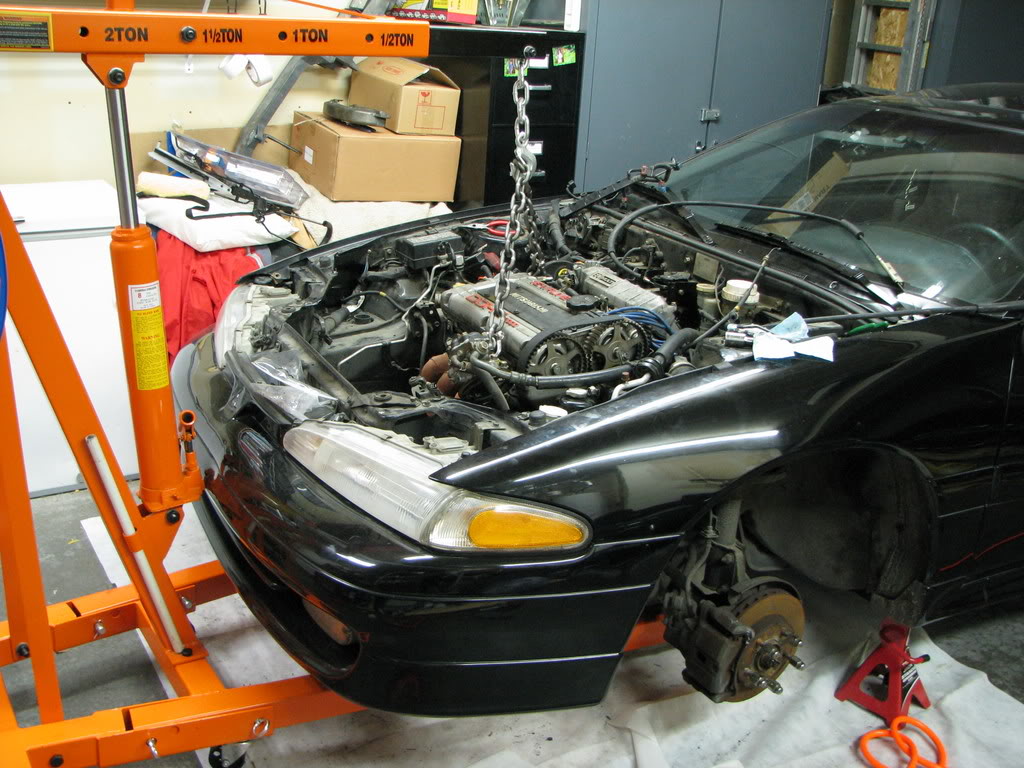

Old Sep 20, 2007 | 05:23 PM
BLAZE GS's Avatar
Posts: 278
Default RE: Drive Line?
this is what im doinName:  IMG_0748.jpg
Old Sep 21, 2007 | 10:16 PM
estraw's Avatar
Posts: 2,465
it would be a lot easier to just unbolt the bellhousing from the engine and it would save you a lot of effort and time
