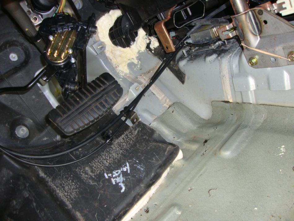

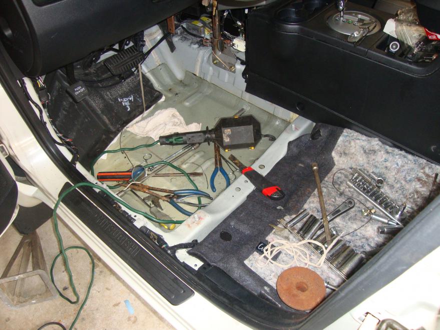

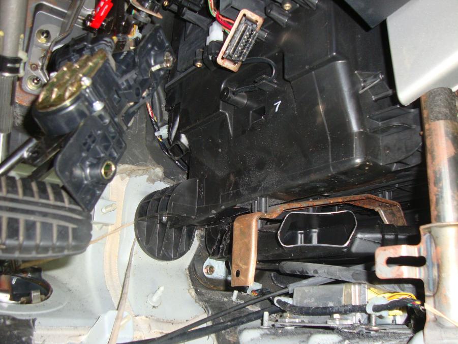

Default $1,000.00 versus $6 to solve A?C water leak!
The cost (1,000.00) of outside repairing compared to the value remaining in my ride was assessed the same as yours. That is why I climbed the mountain, repairing the water leak for $6 bucks.
After removing the driver"s seat, I drained about 1.5 gallons of water from the floor pan by removing the rubber grommet from the underside floor board. I carefully removed any rubber/vinyl trims to free up the carpet and its padding and folded it back into the rear compartment's floor board. With a bath towel I completely dried the metal floor pan.
I next put on the garden hose to eliminate the argument of others that the leak was coming from the windshield. I then got inside and had my wife spray the hose all around the drivers door to eliminate rain that may have been leaking past the rubber door moldings. None of this showed any evidence of a water leak at all. After that I cranked the auto and put the A/C on max and waited and waited to see where for sure the leaking water was coming from. BINGO! After a while here came the A/C's condensation water running down by the gas pedal down towards the floor pan.
In my making of a strategy I considered doing just what you suggested. There is only a little pressure (at all) inside the evaporator's air box (as you called it). I really do not remember why I chose another route, but I did pass on making a hole in the box from the inside of the vehicle, then trying to seal it up! I believe that it had to do with the design of the drain and the forward sloping of the pan. The actual drain tube is smaller than a lead pencil!!!!
Here is what I did, but I don't recommend this if you give up easily or try to rush your close and tedious work!!! This was easy but access makes the simple very tough. The remedy was simple but the positioning of your body is extremely demanding.
Here We Go-
There is a material covering the inside fire wall that is part foam padding and part surface sealing rubber. The A/C's box drain passes through the fire wall through and against this material. This material is part of why the leak is occurring as it deteriorates over time. (I was told occurrance is at approx 60 - 80,000 miles or longer) I took a razor knife and cut this material and removed it completely from around the silver dollar size plastic plate that is part of the evaporator box and has the small tubular drain passing through it and into and through the fire wall. This plate presses against the padded material.
Secondly I made picks out of two welding rods to where I could work out all of the padding material until with these rods and could feel with them and identify the small tube behind and near the center of the plastic silver dollar size plate.
I next took a pair of shoe strings and with the rods worked a half wrap around the plastic tube behind the plate and pulled the shoe strings back and forth, and back and forth to clean out this tight space, and especially clean the tube which you cannot see but you know that it is there.
Next I took the sticky fiber strings that are used to plug flat tires and twisted several togeather until this was about maybe half as long, or a bit longer than half the length of the shoe string. I used a staggering and twisting approach to making this sticky cord. I then worked it behind the plate by tying it to the end of the already there shoe string and pulling it into place behind the plate and against the tupe. I began at 11:00 Oclock and worked my way around clockwise packing the sticky cord in tight with the rods and against the tube to make the best seal that I could. When I got back to the 11:00 Oclock position I cut the cord about 1 inch longer than enough to make the complete circle around the tube, and then worked that end over and down and against the starting end of the cord.
Next I had a can of the "Great Stuff" spray foam that goes in as a liquid and expands into a dense foam like yellow styrofoam. And I put the red nozzel tube into that can and filled up the remaning area/space behind the plastic plate and also filling up the void where I ahd cut away the padding that was around the plastic plate and tube.
Finally after all this dryed, I went again under the car and found the hole that is in the unitized body channel that goes from the drivers side all the way across the lower fire wall to the passenger side. With a piece of mallable bailing wire I fished and fished over and towards the drivers side and inside that channel until the tip of the wire entered the drain tube's opening. I left the wire as far into the tube as I could and slid a piece of small vaccuum hose over the end of the wire, and slid it over the wire up to the opening ot the tube. Once there I blew compressed air into the open end of the vaccuum hose thus directing as much of the air flow at the opening. This is not a flush seal but is better than just blowing through the hole in the body channel and easier than cutting away the channel to permit direct access to the drain hole.
Eureka. No more leaks and that has been months ago. My carpet eventually dried out and is like a powder keg now.
I don't understand why somethings are engineered like they are? Most sane engineers in the past ran the drain through the fire wall or out of the floor board bell housing so it could be kept cleaned out and free flowing. It is almost like Mitsubishi hid this one on purpose!!! And I certainly don't understand why Mitsubishi with so many people having this problem do not address it on their $1,000.00 bucks not ours???
God Bless and Good luck with your mechanicing. And thanks to all of the other forum friends who have made comments and suggestions that gave imputus to me in finding my own unique solution. Especially for $6 bucks. Wow What A Savings. SEE THE ATTACHED PHOTOS OF THIS PROCESS.
Picture 1 shows the work area seat and carpet removed.
Picture 2 shows the padding cut away and the white shoe string in use
Picture 3 & 4 shows the tire plug cord covered over with "Right Stuff"
Picture 5 shows the infamous hole in the body channel in the lower engine compartment that only will allow you to search to find the actual drain hole in the firewall beneath the channel? What bright person engineered this?
