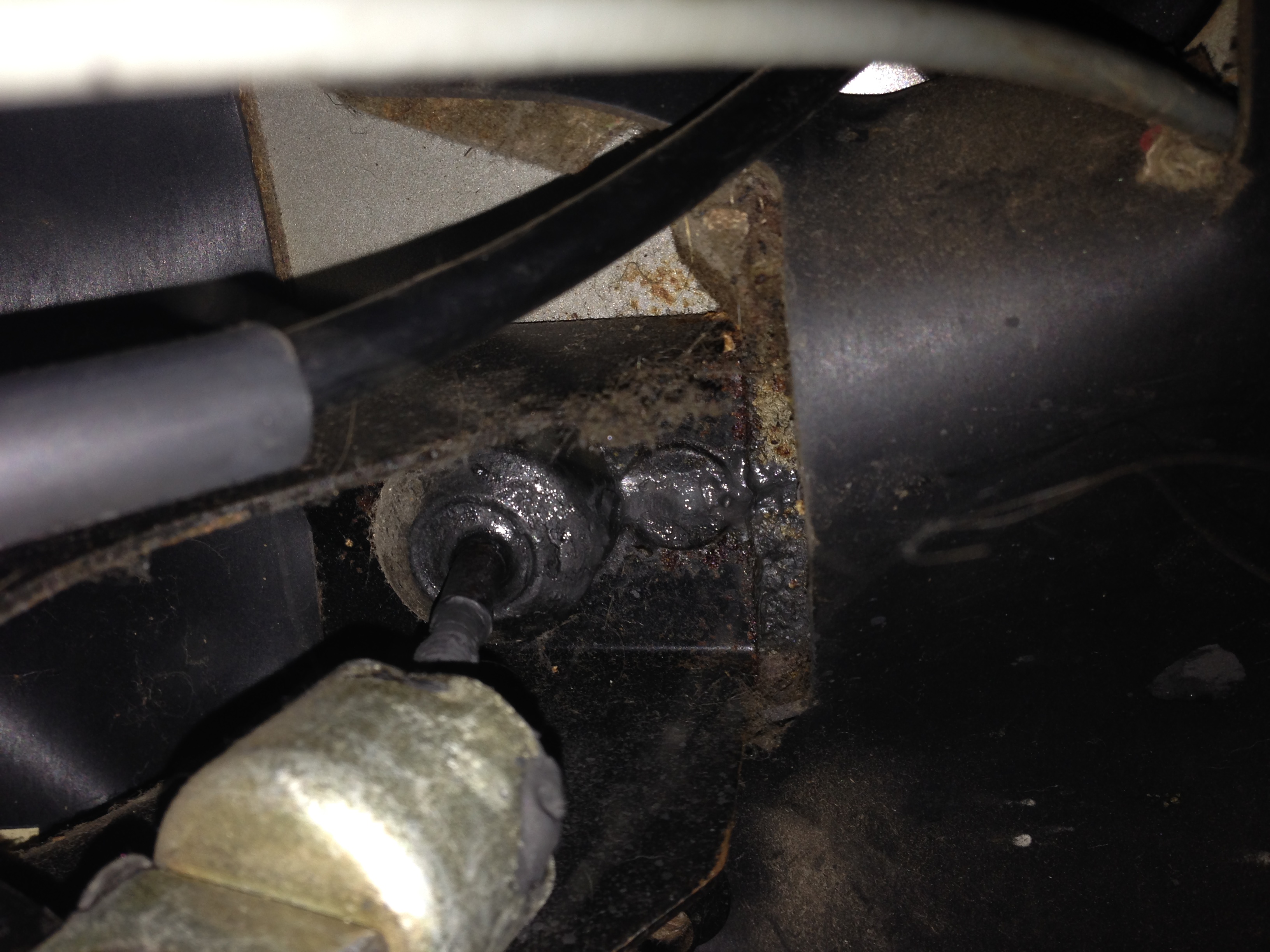

I have been bleeding m clutch for air and a few days later it gets soft again or after sitting. I found that it was the Clutch is leaking from under the foot pedal. what do i need to replace? Thank you.
