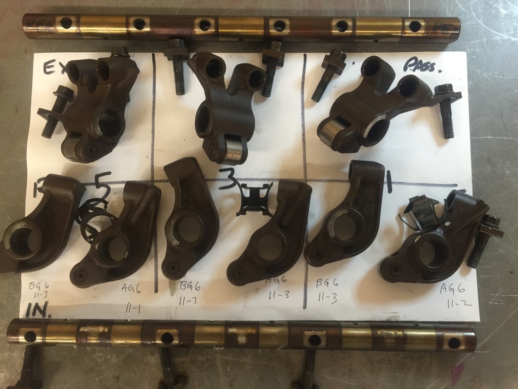

Default Rocker Arm and Shaft Disassembly
Next I carefully disassembled the rocker arms and shafts for cleaning. I did one cylinder head at a time and used a labeled piece of paper to ensure no mix up of components.
The intake rocker arms had numbers cast on them so I made notes of these as well. I also scribed the rocker shafts with their as found orientation on the front end cap and the lettering is perpendicular to the bolt axis so I know which way is up and front. Labeling was DI, DE, PI, and PE for Drivers, Passenger, Intake, and Exhaust.
Attached Thumbnails 2002 montero sport 3.5L engine removal-rocker-arm-shaft-disassembled-intake-exhaust.jpg   2002 montero sport 3.5L engine removal-rocker-arm-shaft-disassembled-intake.jpg   2002 montero sport 3.5L engine removal-rocker-arm-shaft-disassembled-exhaust.jpg   2002 montero sport 3.5L engine removal-rocker-shaft-intake-oil-feed.jpg   2002 montero sport 3.5L engine removal-rocker-shaft-exhaust-oil-feed.jpg

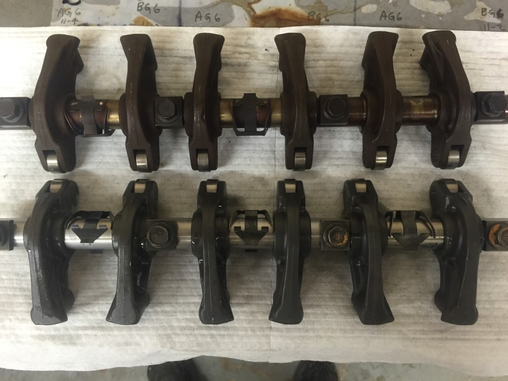

Default Rocker Arm and Shaft Cleaning
Next I proceeded to clean the rocker arms and shafts.
I used a length of 1.5" PVC pipe with a glued on cap to soak the shafts vertically in Berryman's Chemdip for about 1.5 hours. After removing from the dip, I scrubbed with a scotchbite pad then washed the shafts in hot water with Dawn soap. Quite effective. Shaft was lubed with 30W while waiting for assembly.
The rocker arms were soaked in the Chemdip for about 45 minutes, then also washed in hot water with Dawn soap. Lastly, the rollers were lubed with 30W while waiting for assembly.
Wash, rinse, repeat...

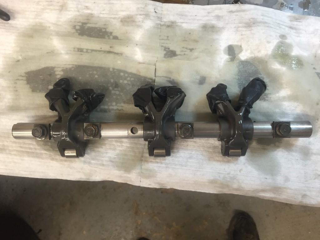

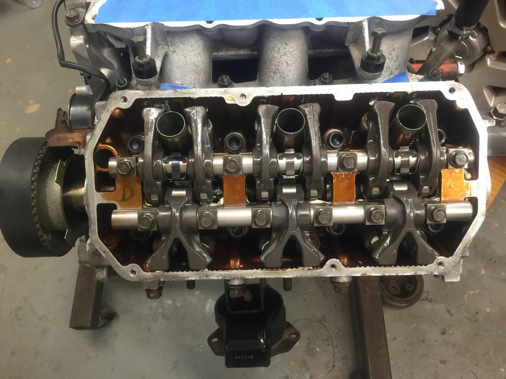

Default Rocker Arm and Shaft Assembly Drivers Side
After thorough cleaning, the rocker arms and shafts were assembled and installed.
Assembly lube was applied to the tips of the valve stems.
I started with the intake rocker shaft, and the rocker arms were reassembled per the order removed. The bores for the VLA's were flooded with 30W oil and with my finger blocking the oil hole on the arm back side, I pushed the VLA's into the bore forcing oil thru the arm.
I did not have special tool MD998443 which is used to hold the VLA's in the arms. Instead, I cut the tips off rubber gloves and used them to hold the VLA's in position while fitting the assembly to the head. Once in position, I snugged the bolts lightly, removed the finger tips, checked to ensure that each rocker arm was properly centered, then hand tightened the bolts. I then fitted the intake rocker arm shaft springs and finally torqued the bolts in 2 passes to specs.
I then proceeded to install the exhaust rocker shaft assembly in a similar manner.
Attached Thumbnails 2002 montero sport 3.5L engine removal-valve-lash-adjuster-holders-made-finger-tips-rubber-gloves.jpg   2002 montero sport 3.5L engine removal-assembly-lube-applied-valve-stem-tips.jpg   2002 montero sport 3.5L engine removal-intake-rocker-shaft-spring-views.jpg   2002 montero sport 3.5L engine removal-rocker-arm-shaft-position-intake.jpg   2002 montero sport 3.5L engine removal-rocker-arm-shaft-installed-intake.jpg
2002 montero sport 3.5L engine removal-intake-rocker-shaft-assembly-ready-install.jpg   2002 montero sport 3.5L engine removal-exhaust-rocker-shaft-assembly-ready-install.jpg   2002 montero sport 3.5L engine removal-drivers-side-rocker-arms-shafts-cleaned-installed.jpg

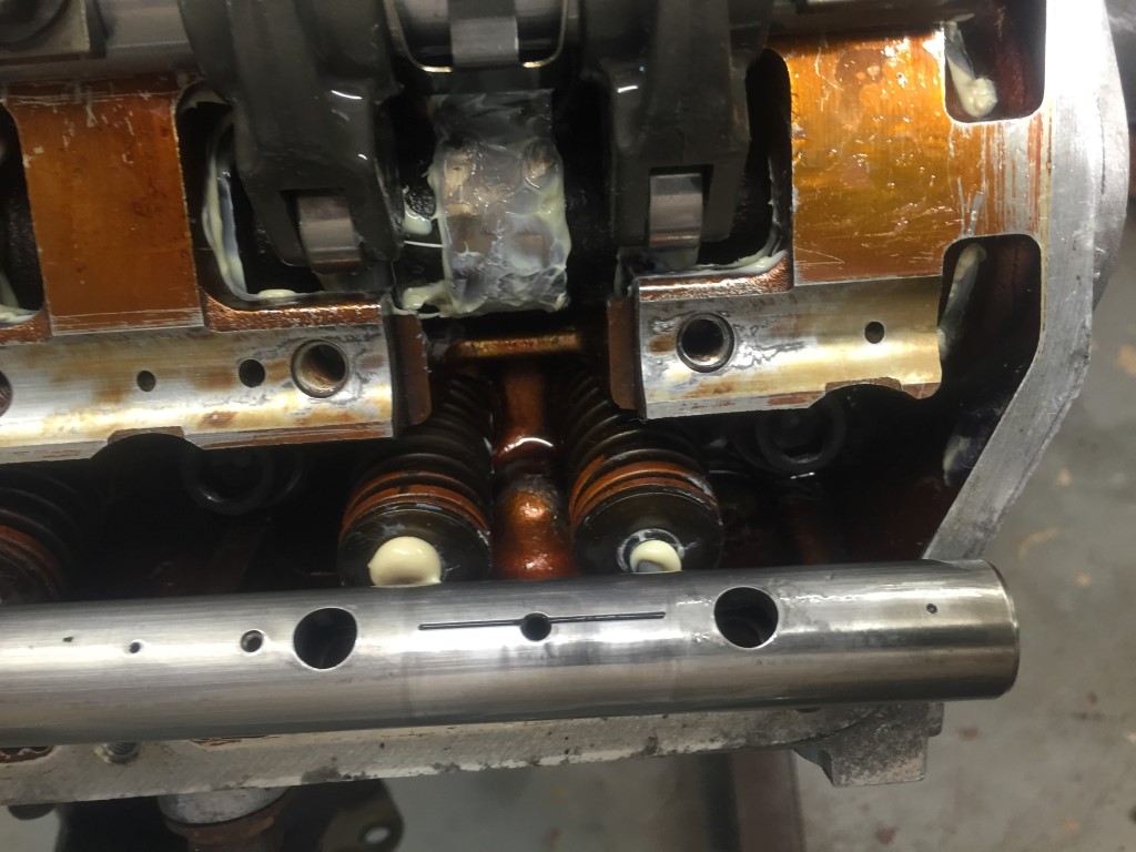

Default Rocker Shaft Orientation
I was very careful in labeling the positioning of each rocker shaft during disassembly and observing the mating of the oil feed holes from the head to the shafts.
The manual has this picture showing that the "notch" on the shafts goes towards the front of the head as evidenced by the camshaft pin shown in the picture. I found this to be in error for the driver's side head where the notch goes to the rear. This is how my engine was as-found and is the only way the oil feed holes line up on the drivers side.
On the passenger side, the notch does indeed go towards the front and the oil feed holes are aligned.
Attached Thumbnails 2002 montero sport 3.5L engine removal-rocker-shaft-manual-error-drivers-side.jpg   2002 montero sport 3.5L engine removal-rocker-shaft-labeling.jpg   2002 montero sport 3.5L engine removal-rocker-shaft-exhaust-oil-feed.jpg   2002 montero sport 3.5L engine removal-rocker-shaft-intake-oil-feed.jpg   2002 montero sport 3.5L engine removal-rocker-shaft-drivers-side-intake-notch-towards-rear.jpg
Old Apr 29, 2016 | 02:46 PM
  #98
I'm rooting for you!!! Love your labeling system for the rocker arm parts laid out on the page. Simple and efficient. Brilliant.
Thanks man!
Labeling is key since I can't finish everything in one session. Glad I did it as I found the manual to be wrong on the drivers rocker shafts.
