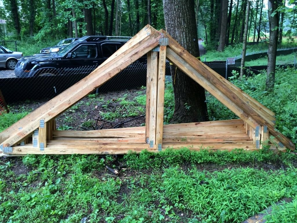

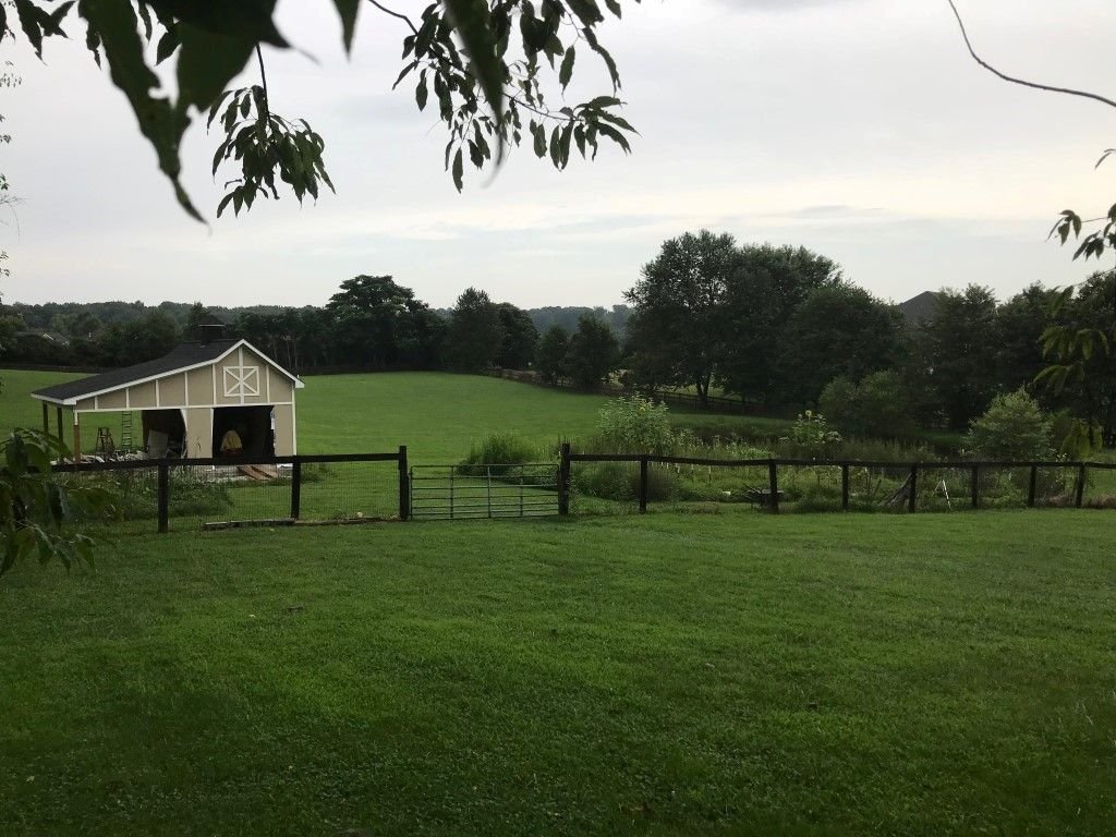

I have a similar problem. My brother gave me a set of trusses that were made wrong. Said I could use them to build a shed. Well the shed has taken on a life of its own. I fully blame him for this 3 year project.
