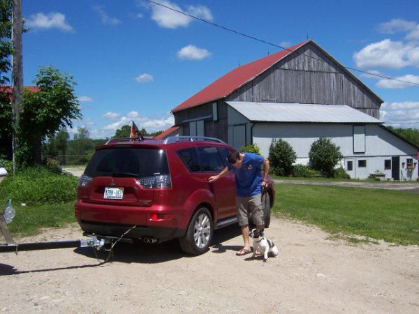

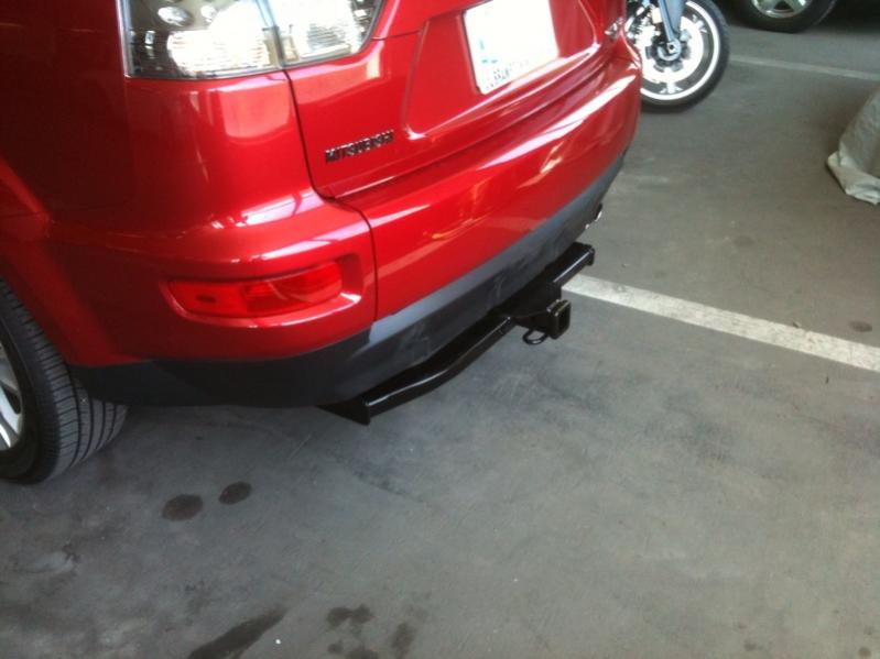

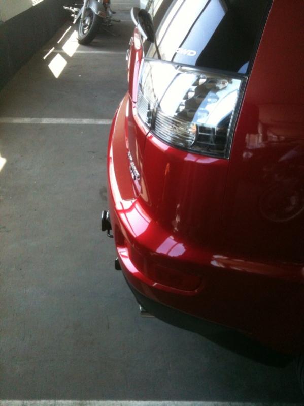

I always install these kind of things my self, but just had to ask the dealer how much it would be for the hitch + harness + install, haha… they wanted $900CDN !!!
So I bought a curt hitch of ebay - $150CDN incl. shipping (came straight from a local warehouse within 2 days) plus a OEM Mitsubishi plug & play harness for around $90 from US. The curt hitch is a class III, rated much more than the Outlander can handle. The hitch itself doesn't hide as well, but it doesn't look bad at all!
Install took me about 20-25min. - Did NOT have to loosen or take off exhaust. I used my array of tools and extensions, to get between the exhaust and the hitch! (I was by myself, so it took a bit longer, as I had to balance the hitch while under the car!!!)
NOTE: I left the harness inside the tire jack compartment, and simply used an elastic to keep the harness organized and tugged away in the compartment. When I use the trailer, I just run it on the right hand side and under the tailgate. This way the cable doesn't get pinched, nor will it scratch the paint. - Why do I keep it inside the Outlander? Well this way the connector doesn't rod/corrode. It will work still work in 15 years, and every time I need to use it. (I am in Ontario, and salty winters here are a bit$%, and destroy everything)
