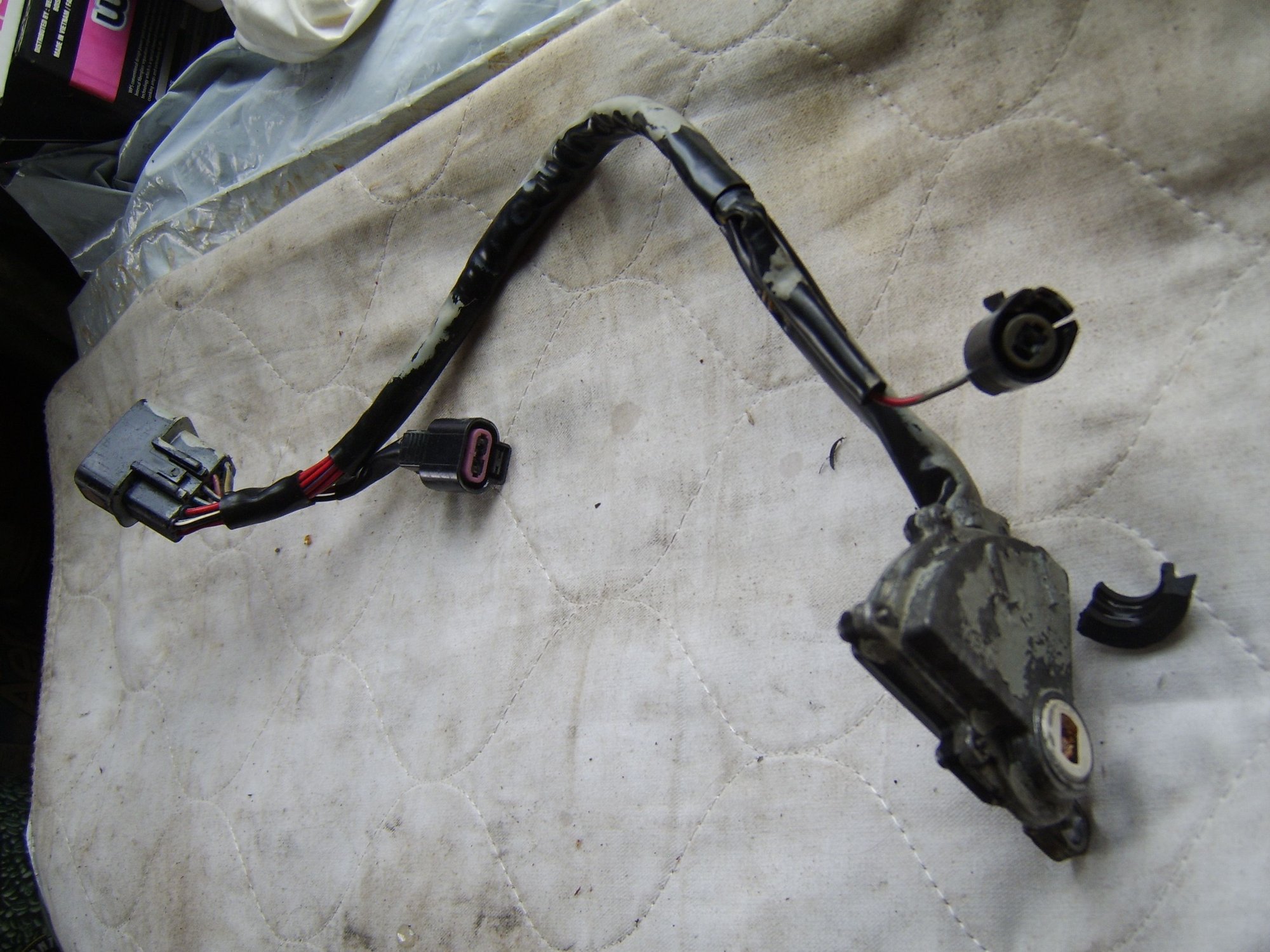

I would say that your Park/Neutral Safety switch went bad. I just replaced one on my 94 Montero and showed how to do it in a recent thread that I posted on this site.

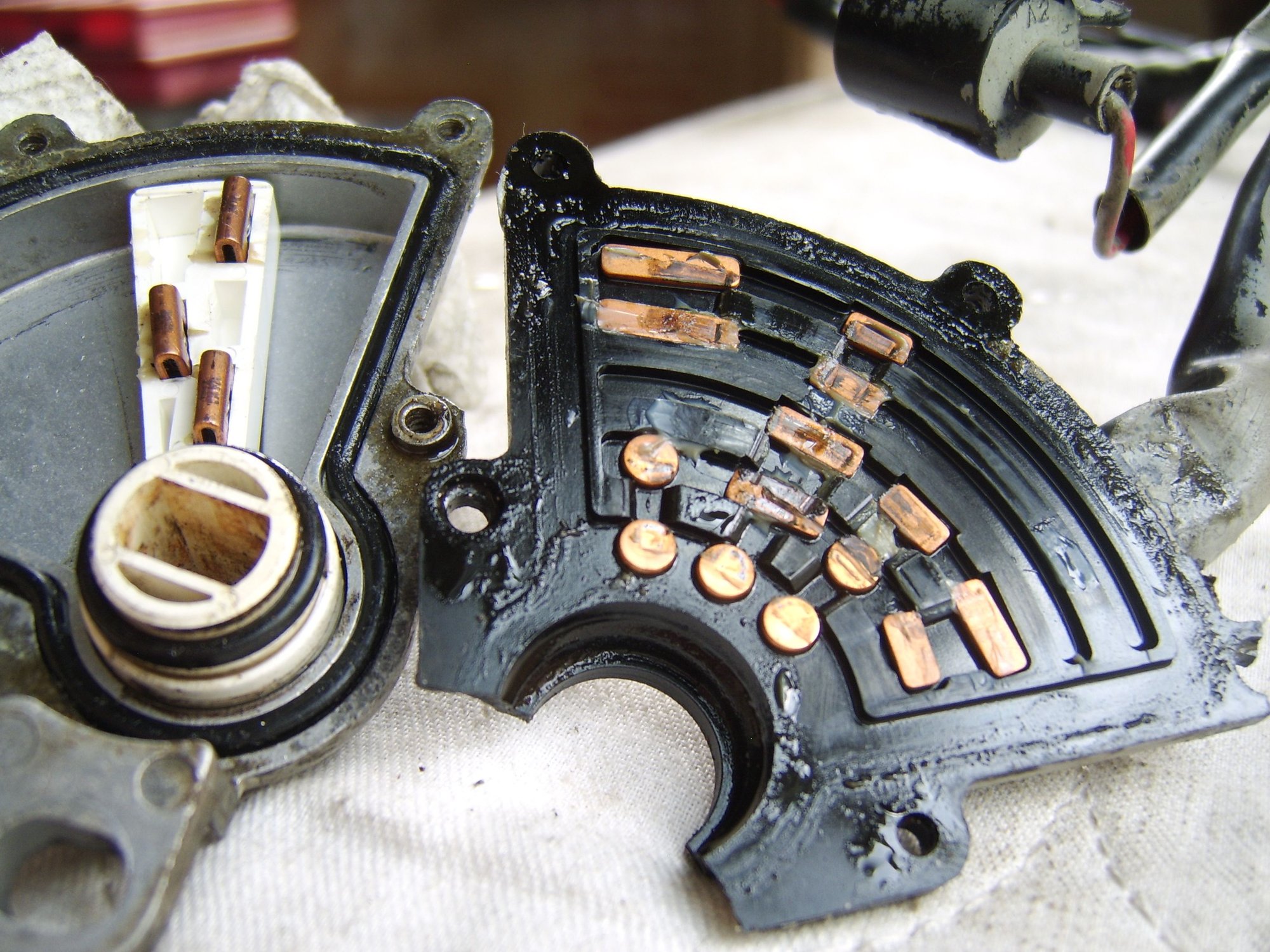

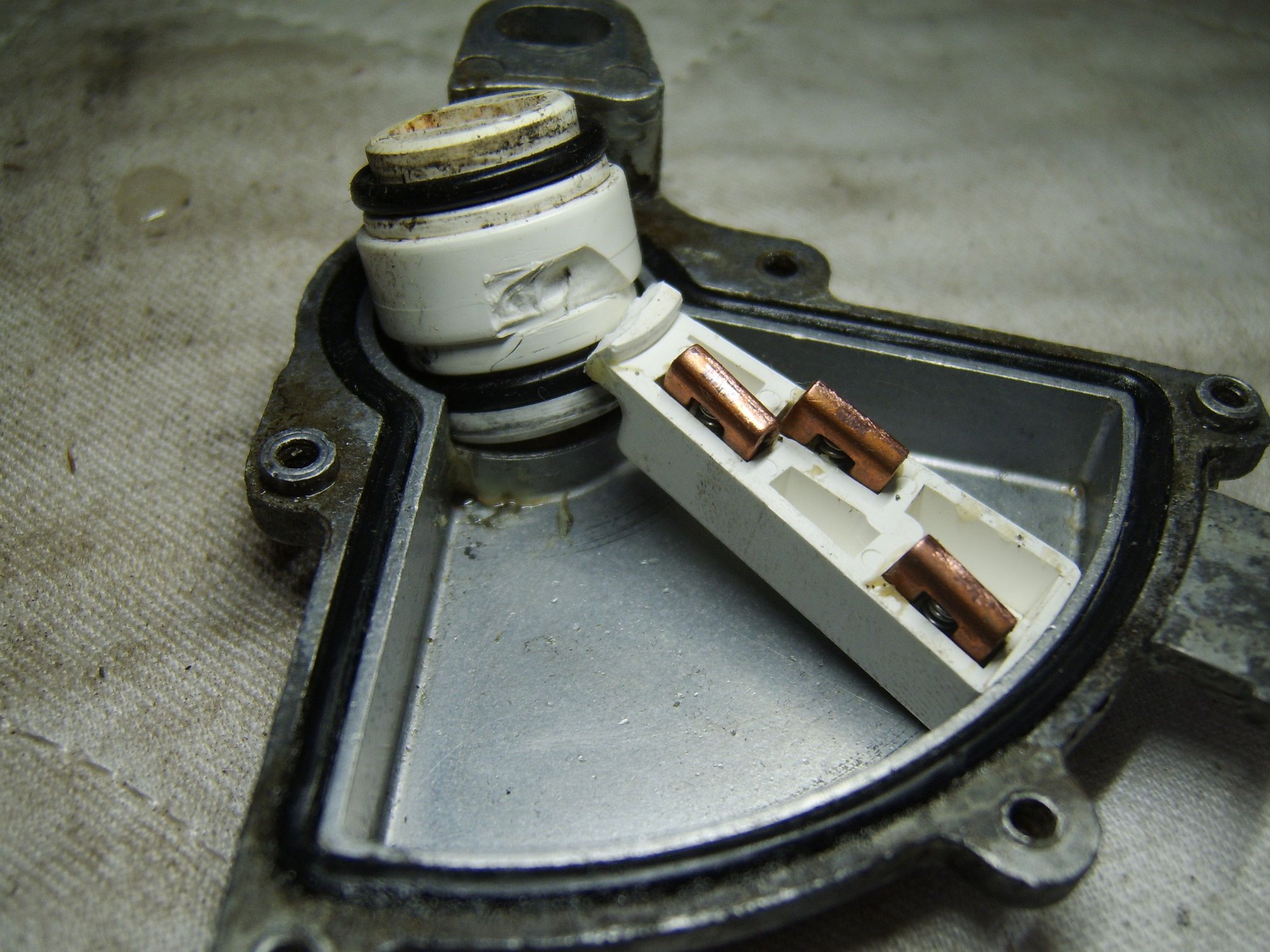

If the little "arm" inside the switch breaks, then the copper contacts could be stuck on the "Reverse" area of the switch, thus making your back-up lights stay on. However, since the switch is probably broken inside, then it should not allow you to start the engine. So, it could also be internal corrosion of the switch. When you shift the tranny shifter, do all the lights come on in the dash......that is, as you move the shifter, the P light goes out, and the R, N, D, 2, 1 lights come on in proper sequence?
Your switch should be similar to this one:
Internal view:
With broken "arm":
