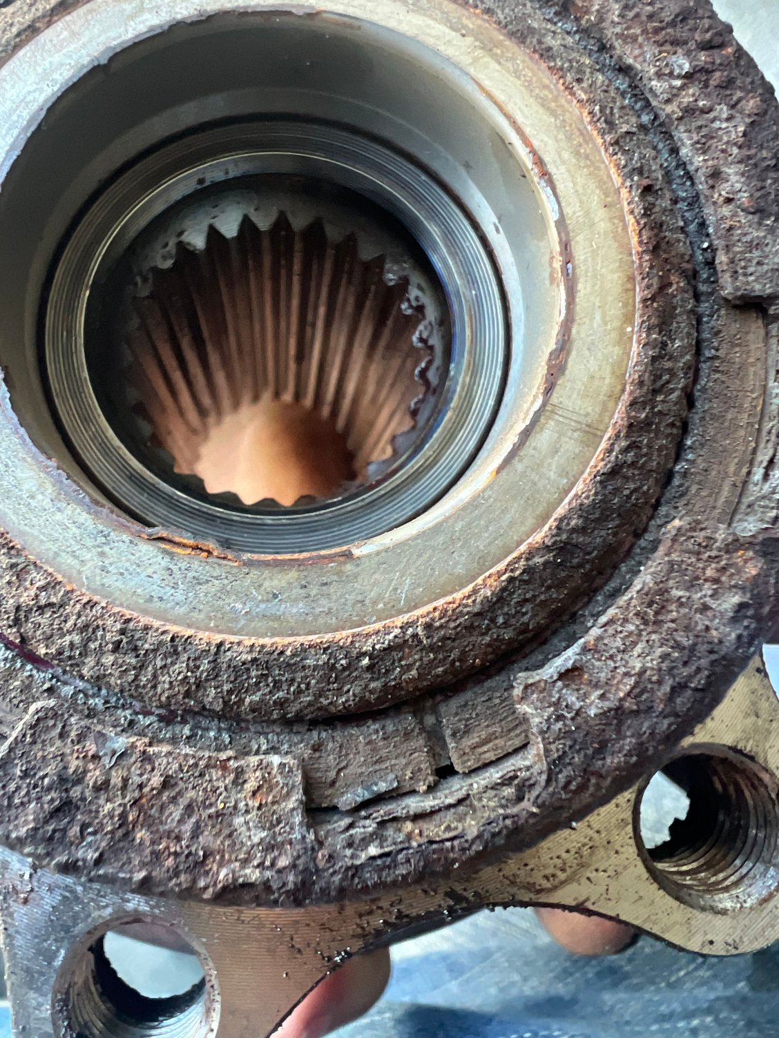

So my dash lights up intermittently (4 or 5 warnings). Took the car to have a screw removed from the tire and they found that the wheel bearing has a crack. Could be messing with the wheel speed sensor. Purchased a rear wheel bearing (OEM part) and will be replacing it and the rear rotors this spring. Anyone else have a crack or other failure before? It appears it common for the wheel speed clip to corrode causing issues…just odd it cracked… Any bear part recommendations? These OEM parts are pricey.
Also looks like a need a new front passenger lower control arm, ball joint is a little loose… my wife did hit a curb on that side a few years ago…

All fixed, appear just the speed sensor ring cracked.
Not sure why this happened…?
