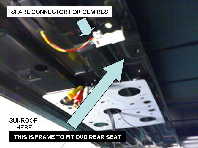

In the image it is possible to see the harness preinstall to connect the RES (this isn't my Outie). . .

where do I find the wires? i have a 2011 oultalnder but I did not see any wiress in the headliner, just the marks for the OEM RES unit. I got mine from e-bay and I was wondering if they didn't run the wiress all the way true.

ionicaw, look post # 11, just update the link for the image, but I don't know if 2011 model is prewired still; this connector provides only power and ground wires to the RES; for audio/video communication between the head unit and the RES is necessary to make some connections (look here pkpaperinik-rdenis method https://mitsubishiforum.com/forum/mi...vd-mmcs-19785/) or buy the Audio/Video Upgrade Harness, part number 8528A023 or newer... (I made ​​my own harness)
