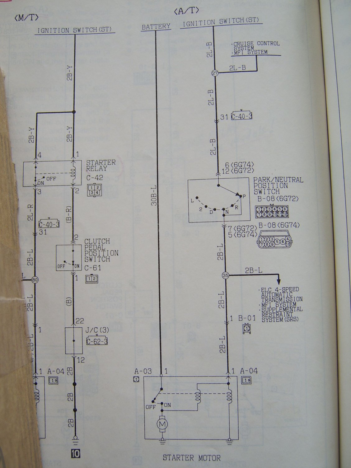

Hello. Under the "Montero Forum" I posted a detailed description and pictures of the current "No Crank, No Start" issue with my 1994 Montero. I will summarize here so as to perhaps get more views and maybe someone will have an answer to the problem.
The Montero will not crank and start.....there is not even a "clicking/tapping" sound from the Solenoid (which usually happens if the battery is weak or poor connections). There is only a small "click" someplace in the dash, which I now think is only the fuel pump relay or Injector system relay. Yesterday I discovered that by simply pushing the Overdrive button to the "Off" position, that the engine cranks and starts up fine. If I turn the engine off, and push the Overdrive button to "On", then the engine will not crank and will not start. Very bizarre situation.
Here is a picture of the circuit diagram:
You can see that after the Park/Neutral Safety Switch, the circuit goes to 2B-L, which covers the Tranny, MFI system, and SRS airbag system. Does anyone know or can suggest what could be the problem at the Tranny that would cause this "No Crank/No Start" if the Overdrive is on the usual "On" position? Why would it make a difference if the Overdrive is "on" or "off" in order to start the engine?

Good morning friend ZZ.......If you go to the long thread called "Help Solve a "No Crank-No Start" Case - 94 Montero with Pictures", you will find the final answer, with loads of pics. In summary, I installed a new Park/Neutral Safety switch which did not help, and had to install a new Relay on the firewall and a Push-Button Switch on the dash below the key switch. Pretty simple install.
