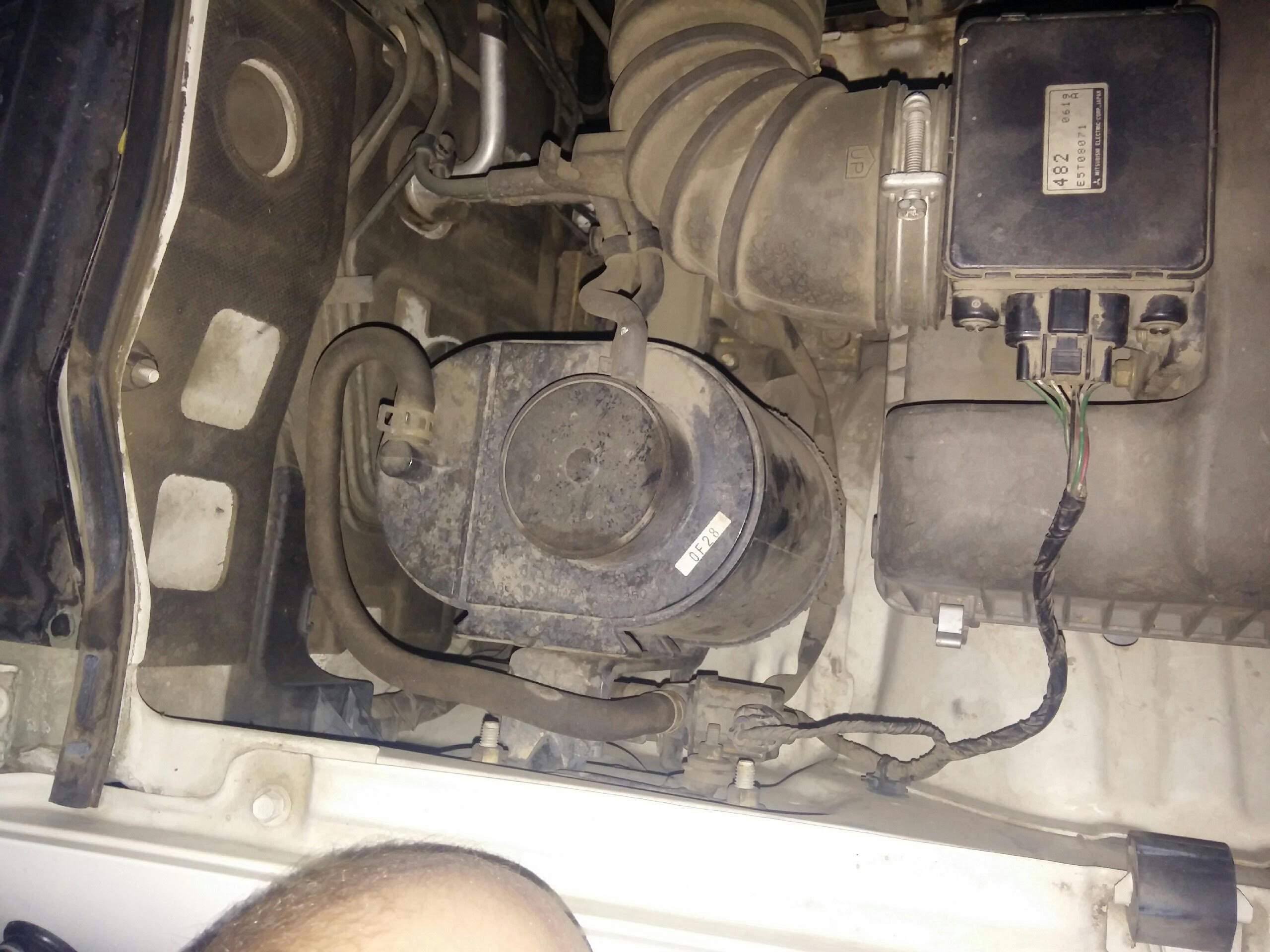

The wire in the last photo (running right between serpentine belt and the engine block) is the crank position sensor wire. It is supposed to be going down that way. There normally couple holders to keep it tucked in right up to the engine, so that it would not get mangled by the belt.
The other connector should go to Evap purge solenoid. Here is a photo what mine looks like. I wonder if PO removed it from your truck.
