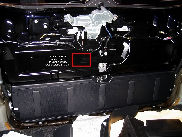

Look at my previous pictures where I shot the cam position where the space is cut-out near the license plate. Eventhough my dealer told me that my car was prewired the location based on a new cabling diagram for the backdoor/tailgate provided by mitsupartsman showed the F21 connector should be at the red sqaure box, unfortunately not on my car. ( November 2008 )

Nothing like that on my European Outlander . Surprised you stated on the "bumper"? You meant the liftgate I guess.
The only prep work i have noticed so far is that the area with the punchout line is now already removed, no sign of the mysterious connector yet...
My backdoor and internal trims are removed , I have the colorcodes from the drawing from Mitsupartsman but no sign of the connector so they either taped it in black properly or I need to go and see the optician :-)
I will check with my dealer BTW..
few days later...
The word is out, today I drove by my dealer and asked to pinpoint where my camera connector should be , well he was as surprised as I was, No connector. I was obviously the "lucky" one where they decided / or forgot / not to install the wiring harness between A style and RH back or Backdoor tailgate.
So I had to revert back to Rdenis guide and this worked , Now my rearview camera is finally working, sigh.
