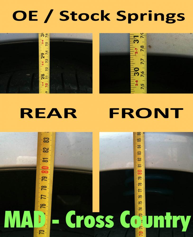

I fitted my 2008 2.2L diesel Outlander with a set of MAD Cross Country springs and the result was a rise of ~30mm in front and ~45mm in the rear, thus leveling the car. (usually the rear is sagging)
The webpage of the manufacturer is: Home | MAD Tooling
A web shop: Mad Suspension Systems - A unique range of suspension upgrades from a single source (but I got mine - part# HV-104281 - cheaper from a local parts shop)
Some pics:
Attached Thumbnails 30mm suspension lift kit - is this POSSIBLE??-hd.jpg   30mm suspension lift kit - is this POSSIBLE??-comparatie.jpg   30mm suspension lift kit - is this POSSIBLE??-box.jpg   30mm suspension lift kit - is this POSSIBLE??-front.jpg

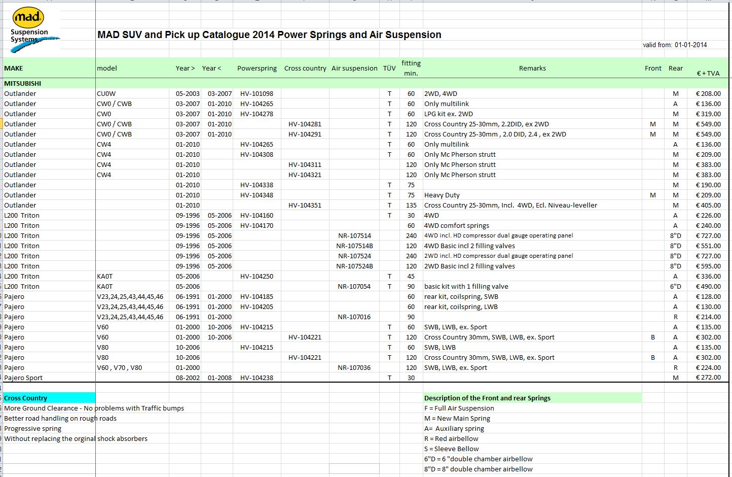

Yes, there are 5 "Cross Country" kits for Outlander on MAD's homepage. All of these kits include all 4 springs which replace the original ones.
The rest of the auxiliary/helper spring kits include only the rear springs (2 pcs) which are fitted in addition to the original ones and does not raise the car.
2 for outlanders between 2007-2010 (which look like this: http://www.conceptcarz.com/images/Mi...08_06-1024.jpg)
Part number:
HV-104281
Assembly time:
120
TÜV / RDW:
R-T
Spring clamps required:
ja
Comment:
Cross Country raises f/r 25-30mm
Only 2.2 DID
Excl. 2WD
ABS Only
Part number:
HV-104291
Assembly time:
120
TÜV / RDW:
T
ja
Comment:
Only 2.0 DID and 2.4 Petrol
Excl. 2WD
2 for outlanders between 2010-2012 (which look like this: http://www.prlog.org/11067117-2011-outlander-nc.jpg)
Part number:
HV-104311
Assembly time:
120
TÜV / RDW:
ja
Comment:
Cross Country raises f/r 25/30mm
Only 2.2 DID
Only Mc Pherson rear strutt
Part number:
HV-104321
Assembly time:
120
TÜV / RDW:
ja
Comment:
Only 2.0 ?Diesel/Petrol? - not clear
To be checked with the producer if either of these fit the petrol version of the 2010-2012 Outlanders.
one for Outlanders after 08.2012-> (which look like this: http://www.thetorquereport.com/asset...x353-18793.jpg)
Part number:
HV-104351
Assembly time:
135
TÜV / RDW:
T
nee
Comment:
Incl. 4WD
Excl. Niveau-leveller
I'll make some pictures tomorrow, but the safest way to find out which kit is for your car is to send a mail to the producer with your outlander's data: year, engine, 2wd or 4wd, maybe a VIN + picture could also help.

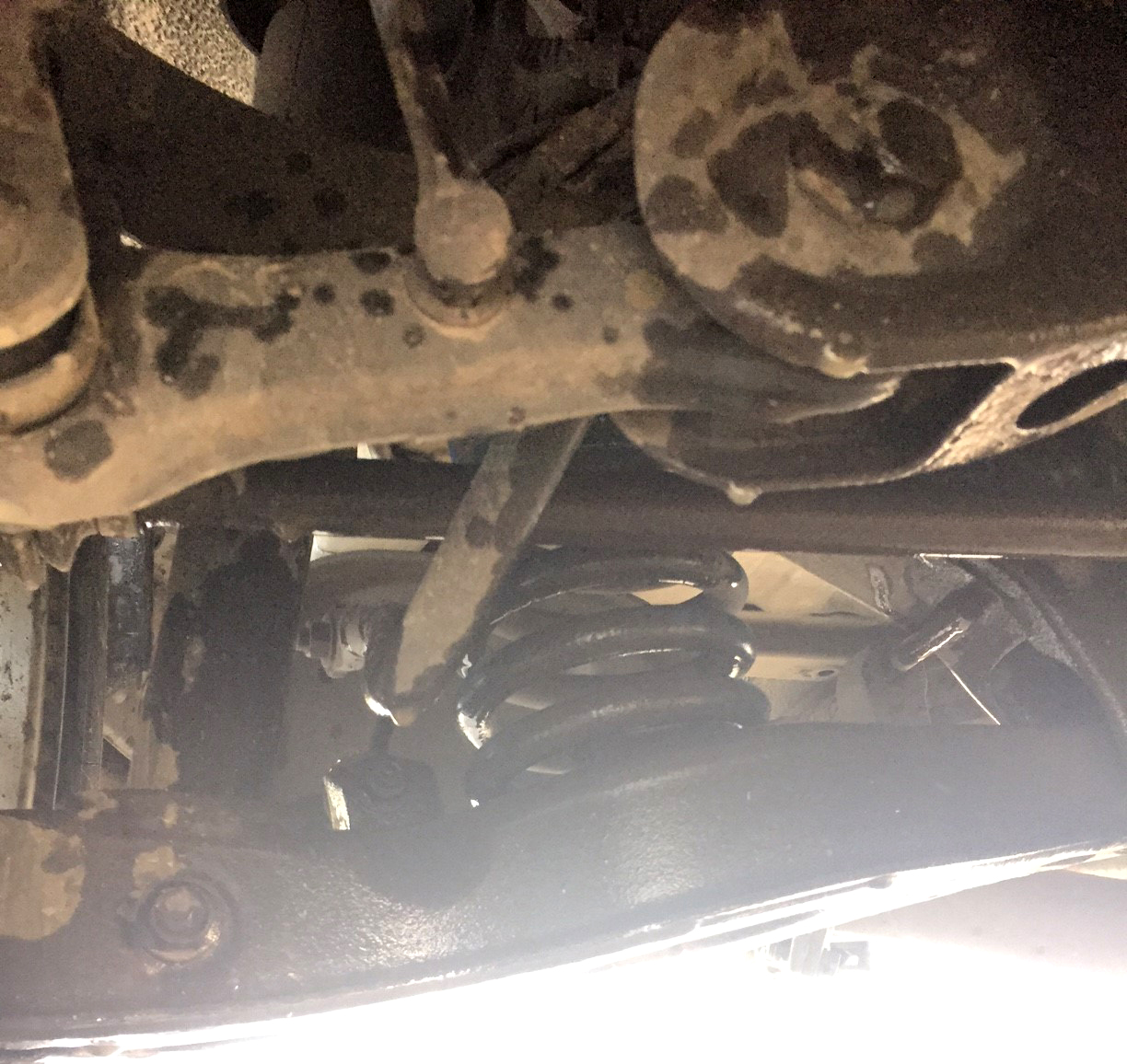

The promised pictures below. If you need a picture of some specific part, just tell me.
Attached Thumbnails 30mm suspension lift kit - is this POSSIBLE??-mad-springs-outlander-2-.jpg   30mm suspension lift kit - is this POSSIBLE??-mad-springs-outlander-1-.jpg   30mm suspension lift kit - is this POSSIBLE??-mad-springs-outlander-3-.jpg

Here's a crop from a MAD catalogue for different springs for Mitsubishi models:
Attached Thumbnails 30mm suspension lift kit - is this POSSIBLE??-mad_mitsu.jpg
